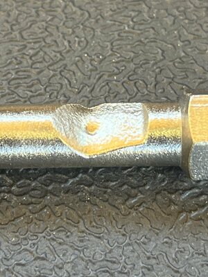

DON'T GET A TOAD FLAT
THIS POST IS SPECIFICALLY TO ADDRESS USING TPMS SENSORS ON YOUR TOWED (TOAD) VEHICLE - NOT YOUR RV (hence the reason this is posted in the TOAD VEHICLES sub-forum)!
MOUNTING TPMS SENSORS ON RUBBER VALVE STEMS CAN CAUSE THEM TO FAIL!
IN FACT, MANY TOP MANUFACTURERS RECOMMEND USING METAL STEMS FOR THIS VERY REASON.
After hearing of yet another valve stem failure (third one in a year), I thought I'd put this out here.
The TPMS sensors weigh around 22 grams, and that is just too much centrifugal mass for the RUBBER valve stems to hold as the tire spins and bounces along the road...ESPECIALLY for you off-roaders! Eventually, the stem will fail, right at the base and you may not even notice it until the worse time; when you're driving.
If you're lucky, like we were, the failure happened on a 115º day parked just a few feet from a tire shop. If you're not lucky, you'll have a catastrophic event as you're towing down the road; far from help!
I have TWO RECOMMENDATIONS:
- REPLACE YOUR STEMS WITH HIGH-QUALITY METAL ONES!
Don't cheap out; my shop had these name-brands for $30. You'll need to find a model that's compatible with your factory sensors, if you have them, which mount to the base of the stem inside the wheel. - REMOVE YOUR SENSORS WHEN NOT TOWING!
Yes, why cause battery drain and unneeded stress when the TPMS systems isn't being used? Instead take'em off and toss them into a bag. I use high-strength P-TOUCH labels to identify them...gotta be sure they go back on the correct wheel!
This happened just yesterday on a friend's Jeep. Fortunately, he found it while he was local and was able to take it to a tire shop.
