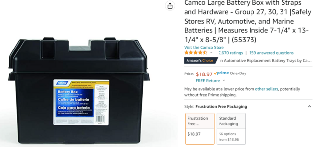

Well hello everyone, I just thought I would post this for any of those who bought a new travel trailer (like myself) and wanted to be able to disconnect the battery easily while storing it. I installed a battery isolator switch on my trailer because for some reason the propane detector on this new trailer was drawing a lot more power than my older trailers allowing it to discharge the battery over a few weeks or so (even with a small 30 watt solar charger connected to my 42 amp hour battery). To date I have increased my solar to 150 watt, but I still switch off the battery to isolate it while it is stored. Below is what I used when adding an isolator switch and upgrading my battery from a 42 amp hour battery (why do they even sale Travel Trailers with dinky 42 amp hour batteries) to a 105 amp hour battery. Consider this trailer has an external battery (my first trailer had an internal battery bank, but this one has it outside by the propane tank). Everything was purchased through Amazon except the battery which I got from Batteries Plus.
Total Cost to Install Isolator Switch and 105 Amp Hour Battery w/case was $217.51 plus tax
1 Water Proof Battery Isolator Switch $13.99
1 Cable set 4AWG 3/8 lugs 2ft $19.98 (only used one cable - the other is for another project)
1 105 Amp Hour Battery $149.99
1 Large Camco 31 series battery case $18.97
1 pkg self-tapping screws (1 package of 100 - only used 4 screws to attach battery case to frame through the base) $7.43
1 tube Black RTV silicone $7.15

3. Remove two self tapping screws from the base of the old battery box and toss it away.
4. Install new battery box (if you are upgrading) using 4 self tapping screws inserted through the base of the trailer battery box to the frame on your trailer (angle iron support).
