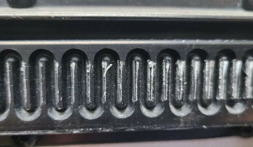

The manual says it is a Norco cable system, but when I took the trim off, there are no cables. I looked online at the Schwintek system and mine has 2 of these rails on either side of the kitchen slide. One at the top and one at the bottom. The bottom right is the one that is making the noise and chatter.

thats a Schwintek system, I had those on my last 5th wheel, never had a problem so I have no maintenance experience with them, are they loose?
The rails are not. The right side starting groaning and sounding like there was something stuck under it the last couple of trips out last season, but I ran it out and looked under the bottom seal, but didn't see anything. I'm going to try and sync the motors based on a YT video I saw this morning and see if that will help.
