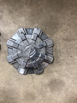

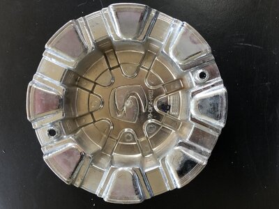

I am looking for a center hub for the rims in my 2014 Roadtrek popular 190
can anyone help ?

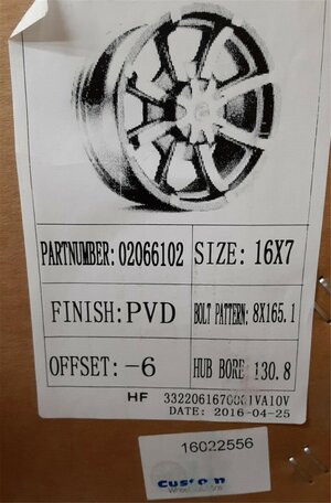

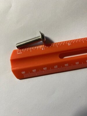

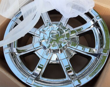

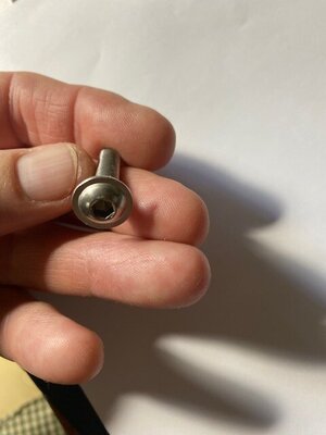

Your Aluminum rims were manufactured by Custom Wheel Solutions in Georgia. 248-761-4540...844-943-3533. Your Rim is part number 02066102. Finish is PVD. Size is 16 x 7. Offset is -6. Bolt pattern is 8 x 165.1. I sent them an email requesting them to manufacture new hub covers for me but they didn't respond. I didn't call them yet. I'm busy with other stuff. Since Roadtrek was seized and sold to another company, I think they can legally remake that hub cover. Even better would be a modified version without the "R" in the center. If you have success, please post your results here. Also, throw away the Allen head bolts that hold your covers in place. The cover cracks, fails and falls off. You need a longer bolt with a very wide head. I bought a bunch of them. This will prevent loss of your center caps.

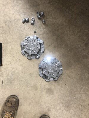

Thanks. I also need a missing a center hub. Please keep me in the loop if on is available. When the company I purchase from put on new tires...they failed to even screw the smaller screws tight...so I just lost one. Thanks, JEar

I already exhausted all those resources long ago and so has every RT owner looking for a hub cover. The fact is that there are no spares in existence and the manufacturer of the original hub covers is not interested in manufacturing new replacements. There just isn't enough profit for them in a small production run. Our Rims are orphans. Joe
ps: I believe the only way to procure replacement hub covers is to have them made. If the original producer will not make them, who will?
