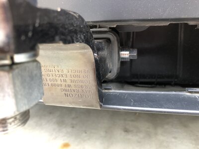

Howdy folks. Today’s project was to quiet down the noisy hitch receiver ball mount thingy. There is always some play in these things and every stoplight you can hear the clunk as it moves in the receiver. I wanted to use one of these.
But the Tesla wasn’t cooperating as the bolts impacted with the plastic at the bottom of the bumper hitch opening. So, headed back to Canadian tire and got this style.

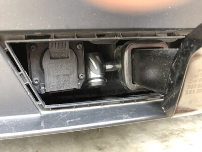

Except without the lock as it would impact with the 7 pin connector. They are available with and without the lock. And the one without the lock is 20 bucks cheaper.

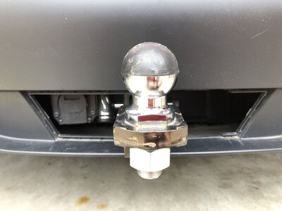

Really easy to put on although you’ll be on your back to do it. And you’ll need a 7/8 inch wrench. Tighten it down good and it will work well. No more noise. Here’s a shot of each side. Tight quarters but not a problem.
Only downside is you won’t be removing it fast as you need the wrench and a couple minutes. Worth it to us for the silence. And we tow our little RV a lot so we leave it on all the time anyway.
Sorry. The safety chain quick links are blocking the shot a bit.
