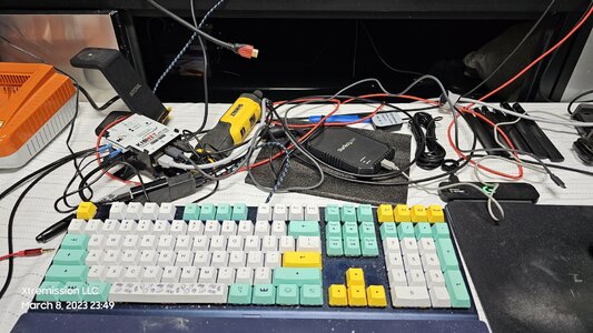

So I took the opportunity to relieve a junkyard of one of the rare, impossible to acquire KIB interfaces that might actually demystify their system functions a bit. It does not disappoint! Far from being the mysterious black box that KIB would prefer everyone believe it to be, it has some rather humble and wonderfully accessible internals:

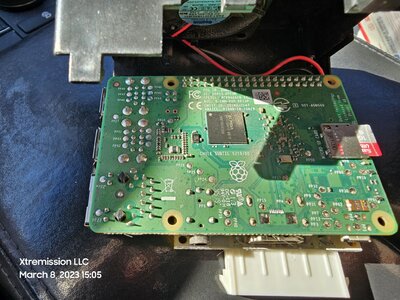

It's a fun little Raspberry Pi 3 running bone-stock Raspbian Lite!

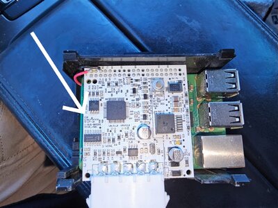

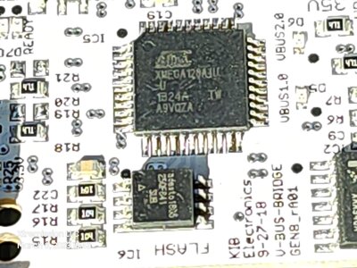

KIB has a nicely designed daughter board for V-bus and power conversion. It also has CANbus connections but I'm not sure on the capabilities yet:

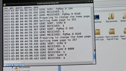

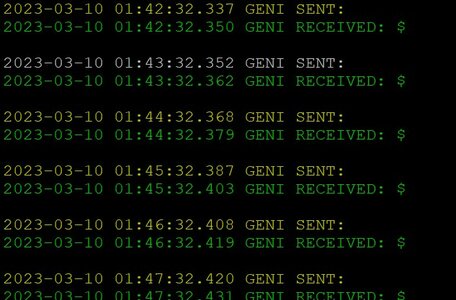

Due to the wonderful engineers at KIB who secretly support open systems, I obtained root access with extreme ease! What's more, it natively gives me a realtime log of ANY V-bus activity (and internal server logging) along with clearly described addressing:
More to come as I figure out how to start bending the Heartland addressing to line up with Newmar's stuff and eventually figure out how to redesign the web UI for remote control. Looks like they wrote it all in Visual Studio. First step will be to entirely liberate the unit from needing to interface with KIB for remote control. Depending on how obfuscated things are this might be an impossible or very complicated task though.

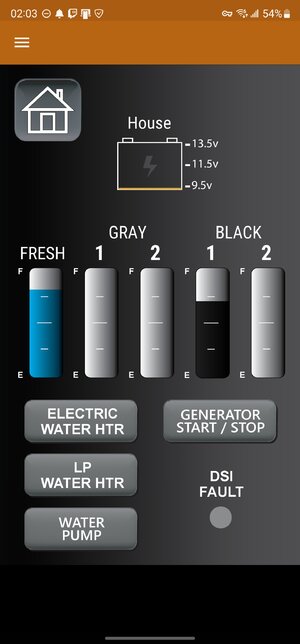

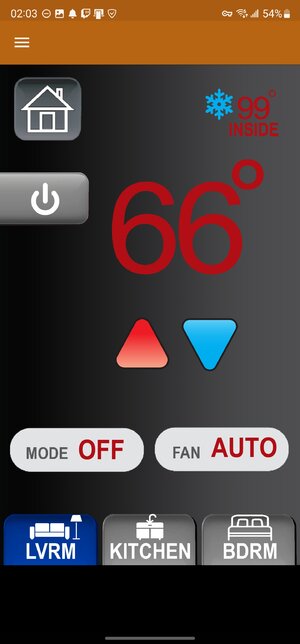

Things learned in first 30 minutes:
HVAC control schema is universal, fully works for Newmar
Some lighting commands are universal (global on/off)
Tank levels are universal (missing pump control)
